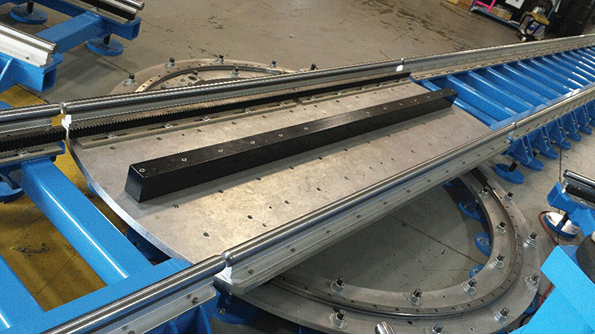

Because NASA wanted to put multiple targets inside the radar range without having to get a forklift to bring them in and out, ADC developed the design of a switching station outside the perimeter of the range. The switching station would actually be a turntable similar in operation to switching stations for railroad trains. Targets atop track sections could be moved on and off the turntable, which would then turn to align that track section with the 110-ft. long track that would bring them into the radar range.
To avoid using a forklift to place and remove objects in the radar range, a switching table was designed and placed just outside the radar range.

The design includes a place to dock positioning components when they are not in use. Curved linear guide rails support the switching station so that the platform can be rotated manually. Hardened tapered pins are used to align the switching station with mating rail segments.
NB Corporation of America machined the custom rails. They are case-hardened steel shafts (SFW 32 × 48 PD) that have tapered ends to improve transfer across the switching station platform. The rail diameter is 2 in. They are supported by NB shaft supports WA 32-48 PD, which are precision-machined aluminum extrusions available with or without pre-drilled mounting holes. They offer continuous shaft support and consistent shaft centerline. Spacing between sections is equal to the pitch of the rack so that transfer is completely motorized.
