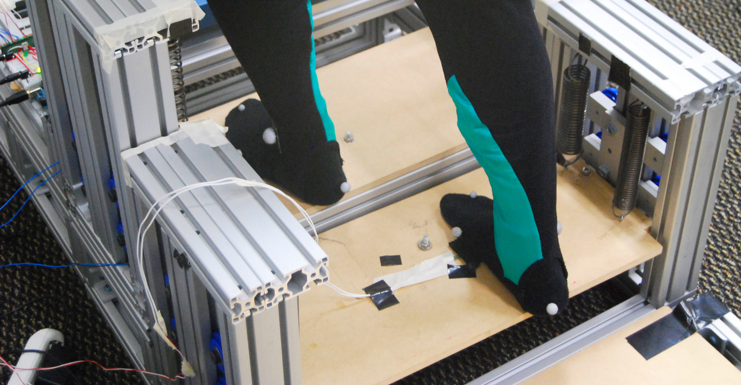

Researchers at Georgia Tech and Emory University have developed a device that makes walking up and down stairs easier. It’s a set of energy-recycling stairs that store a person’s energy during descent and return energy to the next person who climbs the stairs.
The spring-loaded stairs compress when someone comes down the stairs, saving and storing 26% of the energy otherwise dissipated through impact and braking forces at the ankle. When going up, the stairs give people a boost by releasing that stored energy, making it 37% easier on the knees than using conventional stairs. The low-power device can be placed on existing staircases and doesn’t have to be permanently installed.
Each stair is tethered by springs and equipped with pressure sensors. When a person walks downstairs, each step slowly sinks until it locks into place and is level with the next step, storing energy generated by the user. It stays that way until someone walks upstairs. When a person going up the stairs steps on the sensor on the next tread up, it releases the latch on the lower step. The stored energy in the spring is also released, lifting up the stair and the back leg.
