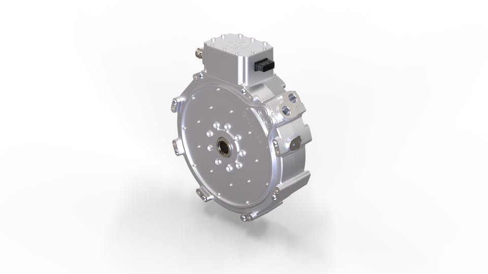

To solve this, the manufacturer collaborated with an electrification expert, who suggested an axial flux motor with a double stack layout (see image below). The axial flux motor was the ideal solution for the limited space because of its short axial length and high power density. The selected motor’s specifications were:
  • Maximum speed – 3,700 rpm
  • Continuous maximum torque – 375 Newton meters (Nm)
  • Maximum torque, at 20 seconds (s) – 875 Nm
  • Continuous maximum power 120 kilowatts (kW)
  • Maximum power, at 20 s, – 310 kW
  • Maximum continuous current – 220 Arms
During rigorous testing, the axial flux motor exceeded performance expectations when integrated as the PMG. It delivered the necessary electrical output efficiently, while conforming to tight spatial and weight constraints.  The generator manufacturer demonstrated the enhanced unit to major EV fleet operators, showcasing its potential for next-generation, grid-independent charging infrastructure.
