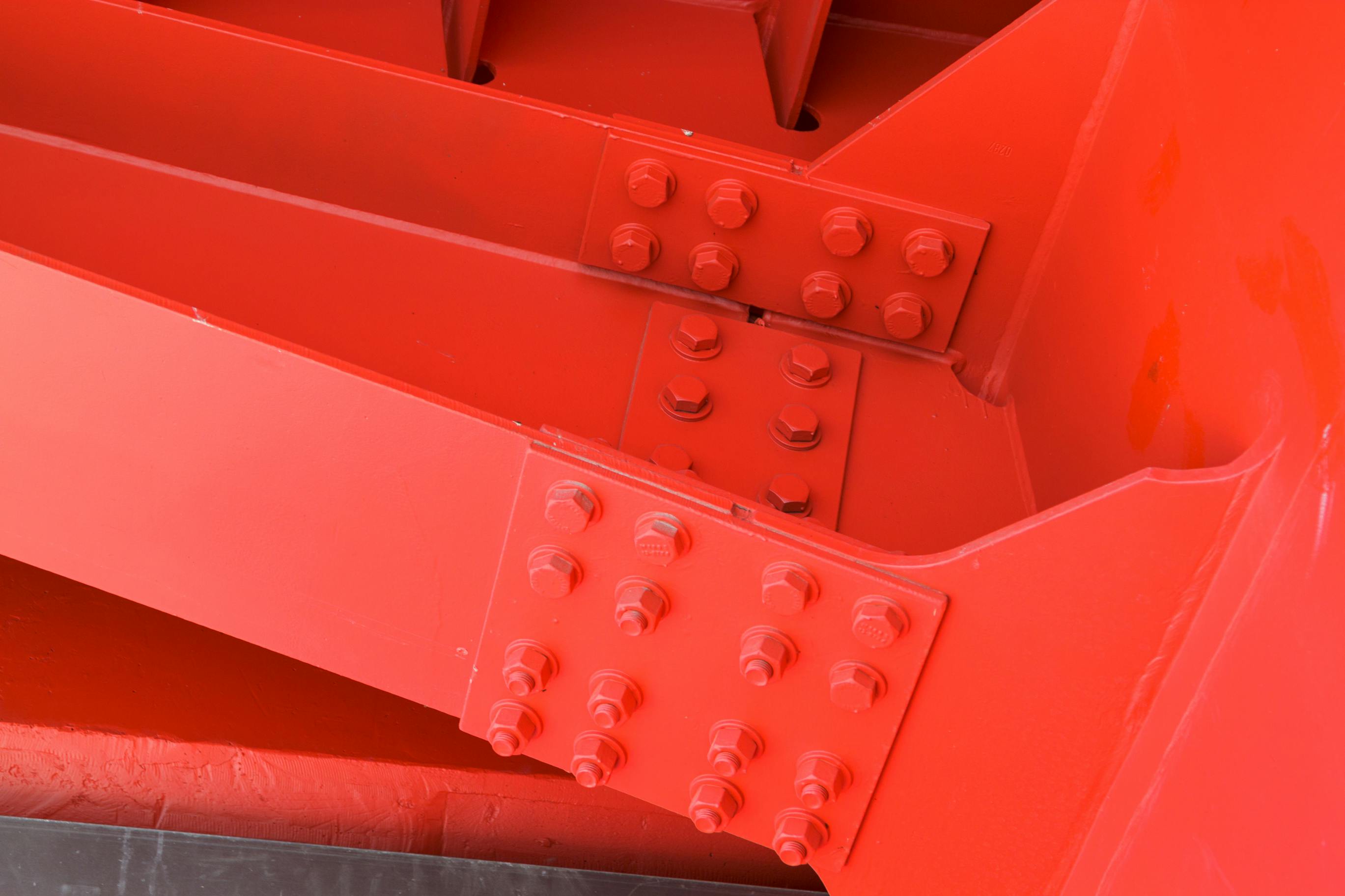

Bolted joints are among the most common structural elements in precision machinery. They are used because they are strong, serviceable and reliable. Yet, despite their prevalence, the moment stiffness of bolted connections—especially under pitch or overturning loads—remains one of the least understood contributors to system accuracy and dynamic behavior.
Most design calculators and handbooks focus on axial stiffness or preload selection, but precision machine structures rarely experience pure axial loads. Instead, they experience a mix of axial, shear and, most importantly, moment loads generated by offsets between applied forces, structural interfaces and real-world system geometries. These moments can cause significant rotation, leading to positioning errors, reduced natural frequency and unexpected compliance.

A bolted joint under axial load behaves relatively predictably: the bolt and clamped members act as springs in parallel (Figure 2). As the bolt is tightened, a strain cone forms beneath the bolt head and nut, which can be visualized using stress birefringence in transparent materials such as acrylic (Figure 3).
Under moment loading, however, the strain field becomes asymmetric. An overturning moment causes one side of the joint interface to enter compression while the opposite side unloads or separates, resulting in a non-uniform pressure distribution across the joint (Figure 4). This asymmetric deformation fundamentally changes how stiffness is generated and transmitted through the joint.
