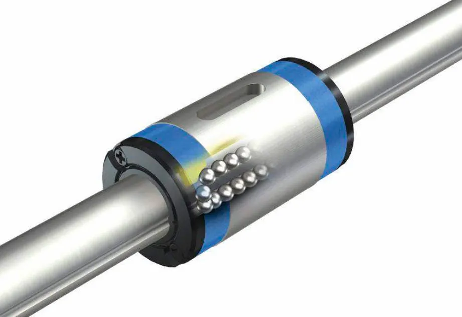

How a Ball Spline Carries Torque and Travel on One Axis
A ball spline pairs a spline shaft with an external cylinder that rides along it. Large recirculating balls run on two raceways and make four-point contact with the spline track groove. As the cylinder translates, the balls roll and the assembly behave like a linear bearing. When torque is applied, those same balls bear against the flanks of the groove and transmit it, so the assembly also behaves like a rotary drive.
READ MORE: Why Ball Splines Matter: The Motion Control Technology Behind Precision Machines
Spreading contact across four points produces a large contact area, distributing the load evenly and limiting elastic deformation as working loads climb. The result is a stiff joint that holds its position rather than winding up under torque. That same contact area also allows the balls to be preloaded. Preload takes up rotational clearance so the shaft and cylinder turn together without losing motion, which matters when a device has to command an angle and trust that the tool got there. It also raises rigidity, at the cost of some added friction, so preload is a specification to tune to the application rather than a value to maximize.
Friction stays low because the balls roll on a recirculating path instead of sliding. Low friction keeps positioning accurate even as breakaway and running resistance vary, and it limits the heat and vibration a sliding contact would produce.

Like any rolling system, a ball spline needs lubrication. In medical equipment, that requirement collides with reality: The mechanism sits in a tight space, the access point is hard to reach and the equipment has no scheduled downtime to spare.
One approach to reducing maintenance requirements is to integrate lubrication directly into the ball spline assembly. In IKO's C-Lube Linear Ball Spline MAG, a porous resin element impregnated with lubricant supplies oil to the recirculating balls through capillary action, helping maintain a lubricating film during operation. According to IKO specifications, the integrated lubrication system is designed to support maintenance-free operation for up to 20,000 km of travel under specified operating conditions.
Paired with a stainless-steel shaft, end plate options and a miniature footprint, the built-in lubrication makes the series a practical choice for clean environments and for applications where opening the device for service is not possible. Eliminating relubrication also removes an oil supply mechanism from the design, lowering total system cost.
