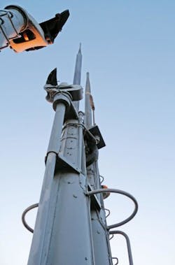

Believe it or not, several key systems are still operational in the 1945-vintage submarine USS Pampanito, docked at San Francisco’s Fisherman’s Wharf. But modern hydraulic modules now run external bow planes for navigation; open and close the torpedo-tube doors; and raise and lower the periscope.
Previously, hydraulic power came from the boat’s original “air-over-hydraulics” unit: high-pressure air is pumped into a hydraulic accumulator, generating the necessary oil pressure to operate the equipment. This air-over-hydraulics system presented several headaches. For one, it took up to a full day to get the high-pressure air system running. Safety considerations demanded trained operators, usually assisted by naval veterans experienced with pneumatic-hydraulic systems. Consequently, hydraulics couldn’t be used often. And because volunteers perform virtually all the work on the Pampanito, maintaining the pneumatic-hydraulic system was problematic.

For the Pampanito, the RexPak has a 71-cc Rexroth A10VSO axial-piston pump driven by a 15-hp motor, providing a 30-gpm flow at a maximum working pressure of 750 psi. The unit includes an 80-gallon hydraulic-fluid reservoir, an in-line relief valve, pressure gauge, and pressure and return filters. This configuration provides enough hydraulic power to raise and lower the 2,000-lb periscope at its original speed, says Butcher.
The power unit easily breaks down into its constituent parts, so it can be carried piece by piece below deck, then reassembled. Other than some special flanges and mounting brackets, the modular RexPak readily adapts to the boat’s existing hydraulic piping and controls — though much of it is decades old. This means the boat’s original controls, on the bridge and in the engine and torpedo rooms, can be used to operate the equipment.
