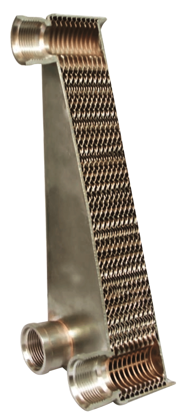

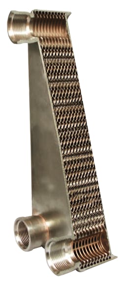

This cutaway of an OAW cooler shows corrugated plates of copper-brazed, 316 stainless steel. The construction helps ensure turbulent water flow that prevents clogging. The high-efficiency unit is up to 90% smaller than shell-and-tube heat exchangers of the same capacity.
