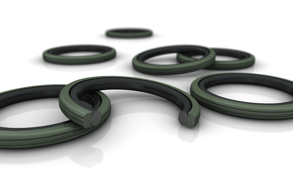

Seals directly impact equipment performance. Used properly, they prevent fluid leaks, extend cylinder life, minimize friction and energy consumption, and improve actuator positioning accuracy.
Seals are engineered to prevent leaks with minimal friction and wear. A number of parameters affect how well they work.
In this two-part article series, we examine a dozen critical factors that influence how seals perform in various applications, offer advice on engineering best (and worst) practices, and review important considerations when testing seals and interpreting results.
It is important that engineers consider all 12 factors when selecting seals and testing them to validate performance. Although the prospect may seem daunting, practical experience with many of these factors helps engineers avoid common mistakes and replicate proven successes. Depending on the application, some are more applicable than others. Here are the do’s and don’ts engineers should keep in mind when looking for the best seal performance.
