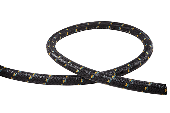

The nylon-fiber-braid cover of Parker’s 293-10 Air Brake hose offers abrasion resistance with operating temperatures ranging from -58°F to 302F° (-50°C to 150°C). Hose designers determine the best materials for particular hose covers based on the intended operating environment and fluid it will carry.

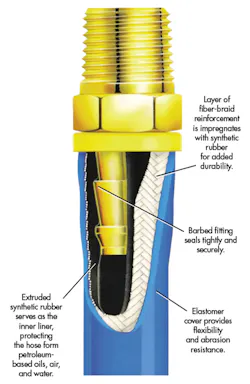

Hoses are designed in layers that get stacked on top of each other, starting with an inner tube layer that resists the transmitted fluid, a reinforcement layer for pressure carrying capability, and a cover (perhaps an elastomer) that makes helps it resist abrasions.

A hose’s pressure rating is determined by its reinforcements, he says. Hoses are constructed in layers, starting with an inner tube, then alternating layers of rubber and reinforcements, such as steel wire. Each reinforcement layer is placed to work with the layer above or below it, so when the hose is pressurized, it creates a hydraulic balance. This balance restricts the hose from moving too much under pressure. If there is no balance, the hose twists or “bounces” under pressure and could start to come apart due to the forces from the pressurized fluid, he explains.
