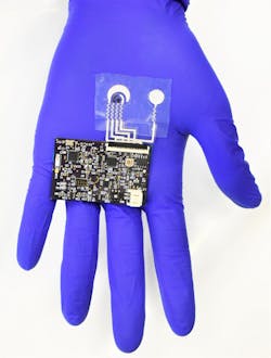

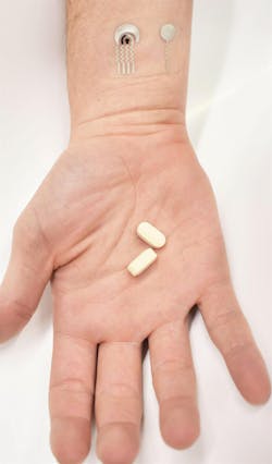

Wearable Device
The sensor consists of a flexible, polyurethane tattoo patch fitted with a sweat stimulation system, as well as an electrode sensor containing the enzyme ascorbate oxidase. When vitamin C is present, noted the study, the enzyme converts to dehydroascorbic acid. The resulting consumption of oxygen generates a current, which is measured by the device.
The device was tested in vitro as well as in four human subjects who consumed vitamin C supplements and fruit juices. According to the authors, the device detected changes in the levels of vitamin C over two hours.
