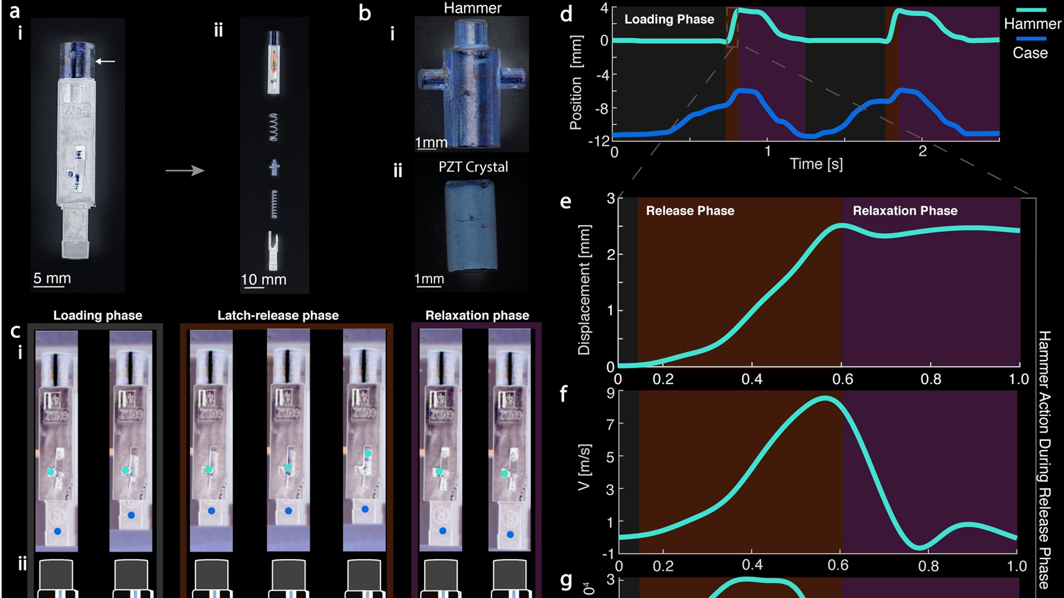

For example, the team tested several different lighter crystals to find ones that produced a consistent voltage using a spring-based mechanism with a 1000-frame/s camera to study the device mechanics in slow motion (Fig. 3). The final bill of materials (BOM) included copper-plated wire, heat-shrink wire insulation, and aluminum tape. To hold it all together, the researchers designed a 3D-printed casing that also serves as its activator. With all of the parts on hand, the device can be assembled in 15 minutes.
3. Spring-latch mechanisms for repeatable generation of high-voltage pulses. (a) Image of the striking mechanism (hammer action) found within the piezo igniter in a lighter (arrow indicates location of crystal) (i). The parts include, from top to bottom, metal conductor (gold-colored region) housing the piezoelectric crystal, springs, hammer, release spring and geometrical latch (ii). The presence of two springs is to decouple the loading and release phase for consistent voltage output. (b) Images of the hammer and PZT crystal. The circular surface area of the hammer comes into direct contact with a pin that strikes the piezoelectric crystal, generating a voltage through the piezoelectric effect. (c) Snapshots from high-speed video illustrating the position of the hammer during the loading, latch-release and relaxation phases (i). Free-body diagram indicating movement of each part through each phase of the hammer action, including activation and deactivation of spring forces (ii). (d) Plot of displacement of the hammer and the lower case as a function of time obtained using high-speed image video. (e,f,g) Zooming into the dynamics of the hammer during the latch-release phase reveals that the hammer achieves a peak velocity of 8 ms−1 in 0.5 m/s, which corresponds to an acceleration of 30,000 m/s2. The explosive acceleration results in a 10-N force (mass of hammer is 0.3 grams) exerted over a tiny area of the PZT crystal. (Source: Georgia Tech)
Noted M. Saad Bhamla, assistant professor in Georgia Tech’s School of Chemical and Biomolecular Engineering, “One of the fundamental reasons this device works is that the piezoelectric crystal produces a consistently high voltage, independent of the amount of force applied by the user. Our experiments showed that the hammer in these lighters is able to achieve acceleration of 3,000 g’s, which explains why it is capable of generating such a high burst of voltage.”
