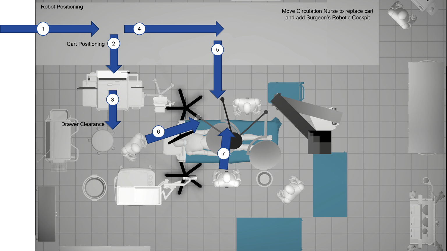

Use-Case Scenario Planning
After modeling the digital OR environment, plan a use-case scenario, which in this case involves robotic-assisted surgery (RAS). Next, storyboard the scenario to determine what actors need interactive features, or kinematics. Since evaluating the design in context will likely reveal unintended interactions, the process will likely be iterative. Along with the storyboard (Fig. 2), there should be an associated script. This will allow the developer to adjust the environment and actor kinematics accordingly.
For example, when the robot is pushed into the room from storage, immediately note concerns due to running into the medication cart. This is solved when the cart is moved toward anesthesia away from the thoroughfare. The next action to take is to open the cart drawer to make sure there is adequate space for the anesthesiologist to conduct his procedures. After continuing to move the robot into the room, then position or dock the robot against the table, making sure it doesn’t interfere with the overhead monitor and lights. Once the line of sight from the anesthesiologist to the monitors and other personnel is checked for any potential issues, then also check the line of sight between the surgeon console to the first assist and the monitors, as well as to other personnel.
Following this script, the developer understands that the medication cart, robot, lights, monitors and patient table will require kinematic features for the RAS scenario. This is the point where participants can put on goggles and gloves to try out the experience. Make sure the room utilized is of similar size as the space the participant is to explore.
