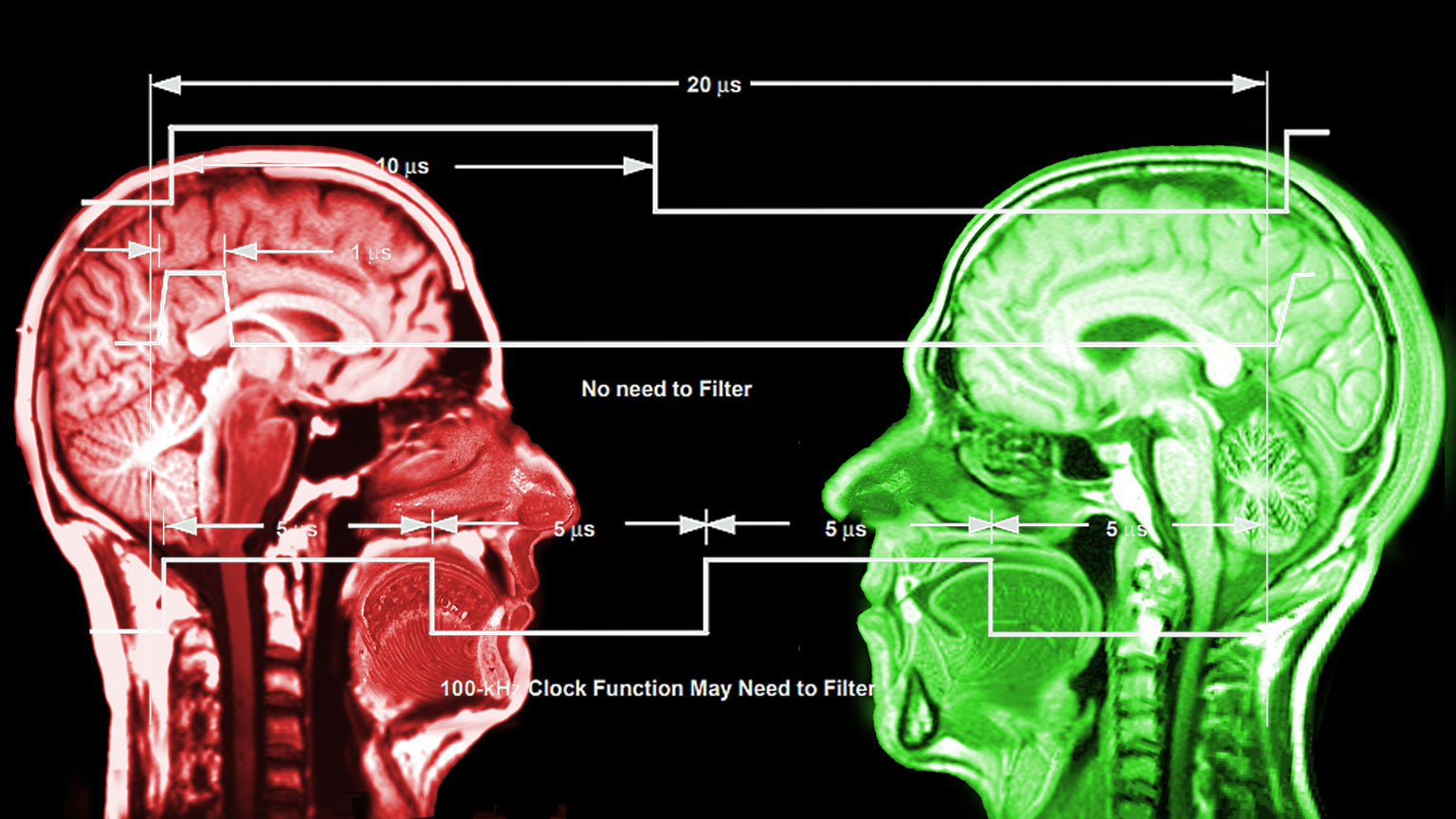

EMI may occur when these three factors are present: a source of EMI, a coupling path and a receptor. The coupling path from the source to the receptor can be a magnetic field, electric current or even an electromagnetic field.
For instance, lightning is an EMI source that occurs in nature. Other sources of EMI might be radios, wireless networks, computers, cellphones or even any electric devices designed to transmit signals. Keep in mind that any signals less than 50 kHz will typically not be a cause of EMI concern (see figure).
