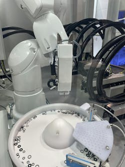

  1. O-rings of varying sizes are loaded into a FlexiBowl feeder where they are separated and picked by a Stäubli robot and inserted into the housing of a demonstration pacemaker located in the first station.
  2. The pallet is moved by the carrier to a vision system that confirms the placement of the O-ring.

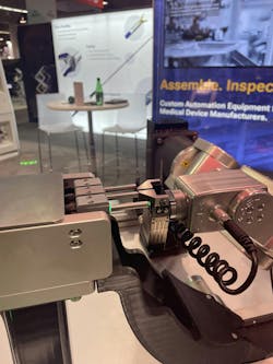

Hahn Automation Group’s second showcase system highlights the use of vision systems and robotics for handling precision components such as stents. This machine addresses four key questions frequently asked by medical device manufacturers:
How to Determine the Right Level of Automation
The system demonstrates a semi-automated production line station, balancing operator involvement with automation. This approach is often ideal for processes that require human interaction but involve delicate materials or tedious tasks that are prone to error.
In this demonstration system, the stents have features such as varying ID/OD (inner diameter/outer diameter) that are hard to detect with the human eye, thus the vision system and robotic components help ensure the parts are placed accurately.
