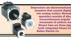

Stepper technology
Stepmotors move or index in fixed angular increments. These motors are used with a command signal that appears as a series of digital pulses. One pulse causes the motor to increment or move through one angle of motion — so one pulse moves the stepping motor through 2.8°, for example. This specific angular movement is repeated for every pulse.
There are various stepmotor designs — those that step through 0.8°, 1.8°, and 2.8°, for example — and various types (such as variable reluctance, synchronous induction, hybrid, and permanent magnet) with the latter being most common.
Most stepping motors are used in an open-loop configuration: A command for movement is issued from the drive, to the motor, and then the motor moves. Here, the command is simply sent; no signal feedback is returned to inform the drive that any operation has, or has not, occurred. In other words, the open-loop control assumes that the movement or operation has taken place.
Stepping motors have two unique speed-torque characteristics. The first is that a stepmotor's peak torque is the same as its continuous torque capability — so there is no extra torque available. As a result, the stepper can stall, or lose steps, if the load becomes too high or inconsistent.
If this occurs, the machine is homed to a known reference position. To prevent this, it is usually recommended that steppers be oversized by applying a safety factor of at least two times the application torque.
The second unique stepmotor characteristic is the slope of the speed-torque curve. Consider the S-T plot on page 19: At 500 rpm, the available torque drops to about 30 to 40% of the stall torque value; as speed increases, available torque drops further.
This characteristic makes stepping motors better suited for applications with lower-speed operation.
