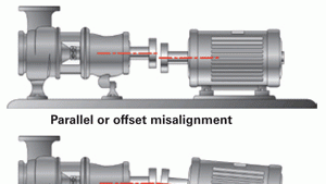

Shaft misalignment
To function at its best, machinery needs to be aligned in both the horizontal and vertical planes. When incorrect alignment occurs, it is often due to parallel or angular misalignment, or more often, a combination of both. The consequences of improper shaft alignment are serious, including increased friction and therefore higher energy consumption, premature bearing and seal failure, and excessive lubricant leakage. Other negative results can include premature shaft and coupling failure, malfunction of coupling and foundation bolts, and increased noise and vibration levels. However, by properly aligning the shafts of rotating equipment (such as an electric motor coupled to a pump or fan), component wear and tear can be reduced and energy consumption minimized.
