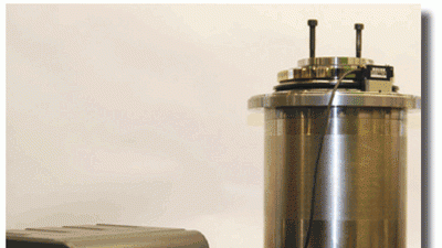

Modular encoder installation
During its installation, scale drums and motor are aligned with the help of a digital readout. (Dial gauges aren't precise enough for this job, and probing with them risks damage to the encoder.) Scale-drum-to-motor concentricity can be set to 0.5 µm — approximately the graduation accuracy of the encoder.
A second measuring head is applied for alignment and is removed afterwards, reliably transferring the encoder's specified accuracy to the motor. The alignment itself requires a maximum of 20 minutes.
In grinding applications in particular, high-precision alignment is necessary because mounting inaccuracies are immediately visible on the manufactured product.

Bearings must also maintain accuracy
The modular encoder design just detailed allows its scale drum to be placed very close to a motor's bearing, which minimizes the effect of error from any bearing tilt — in turn maintaining measuring accuracy. One caveat: Bearing rigidity also affects measuring accuracy, so stiffer designs allow for more accurate measurements.
After smooth motor operation, bearing quality has the most significant influence on motor-axis pulsation height. Therefore, on its HGE torque motors, Schüssler-Technik installs custom axial/radial roller bearings exhibiting pulsation of less than 0.01 µm — comparable to that of hydrostatic bearings. This minuscule pulsation is attained quality bearing raceways and tightly controlled roller geometry. The result is an iron-core torque motor with high power density, but with total axial axis pulsation (from bearing and motor) of less than 0.02 µm.
Motor bearing tilt resistance is also key, particularly for grinding machines that manufacture mineral lenses with diameters up to 500 mm and weights up to 50 kg for the semiconductor industry. Here, precision bearing geometry restricts tipping error to 0.2 µm thanks to weight transfer during motor operation. The maximum axial and radial runout of the axes is 0.3 µm.
