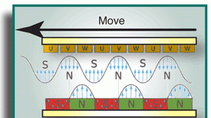

Linear motors are synchronous motors: Current is applied to the coil to form an electromagnet. The coil then synchronizes itself to the magnetic field generated by the permanent magnets in the magnet track. Force in a linear motor is generated due to the relative strength of these magnetic fields and the angle of their intentional misalignment.
One type, linear shaft motors, consists of stationary, cylindrically wound coils and a smooth, nonferrous moving rod; inside the latter is a series of rare earth-iron-boron (NIB) permanent magnets propulsed by attractive and repulsive coil forces. Some of these motors are available with shaft diameters from 4 to 115 mm, and output of less than 1 to more than 36,000 N.

Sine error issue
Consider an ideal scenario: When installed properly, noncontact linear shaft motors are incapable of mechanically binding. The magnets in a linear shaft motor are centered, which renders the airgap dimensions noncritical. The coil completely surrounds the magnet, so force is the net effect of the magnetic field. Any force variation normally caused by airgap differences (from misalignment or mismachining) is eliminated — to simplify alignment and device installation.
In fact, these characteristics are true of all cylindrical noncontact linear motors — so what makes linear shaft motors different from any other design? The answer is sine error — the phenomenon that causes force variations in most noncontact linear motors.
In a parallel drive system, when the separate coils' magnetic fields are perfectly aligned, and the magnetic fields in all the magnetic tracks are perfectly aligned, they in effect become a single motor without any differences of force generation.
On the other hand, any misalignment of coils or magnetic tracks can cause the angle of misalignment of the magnetic fields in the motors to differ, thus producing different forces in each motor. In turn, this force difference can cause binding.
Sine error is the force difference produced by misalignment of coils or magnetic tracks as calculated:
Where Fdif = Force difference between the two coils
Fgen = Force generated
Ddif = Length of misalignment, and
MPn-n = North-to-North magnetic pitch
Most commercially available linear motors have a north-to-north magnetic pitch of about 25 to 60 mm long; such a pitch is touted to reduce IR losses and improve the electrical time constant. However, a 1-mm misalignment in a motor with a 30-mm N-N pitch causes roughly 21% power loss.
In contrast, linear shaft motors use a much longer north-to-north magnetic pitch to reduce the effect of sine error due to accidental misalignment. Therefore, the same misalignment of 1 mm in a linear shaft motor with a 90-mm N-N pitch results in only 7% loss of power.
