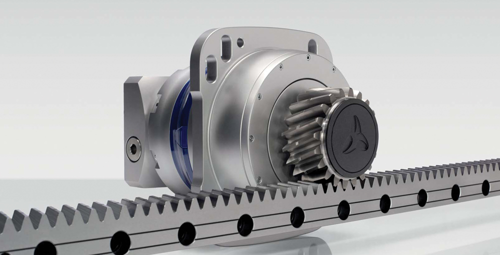

In everything from food processing to construction, steel rack-and-pinion sets provide reliable and accurate linear motion — and always require proper lubrication.
Effective lubrication is essential to ensuring long service life from rack-and-pinion sets because it keeps the subcomponents cool and prevents metal-to-metal contact that promotes wear. Appropriately greased sets are also most capable of reaching their highest rated speed — 1,000 ft/min. or faster — because impacts are cushioned and the pinion is allowed to smoothly engage with the rack. Finally, lubrication protects the sets against oxidation and corrosion, particularly in caustic environments.

A typical automatic rack-and-pinion lubrication system consists of felt pinions, fastening axles, and lubricator sets. Subcomponents are all essential to the process.

    The felt pinion's position is adjusted during installation with a mounting axle so that its soft teeth can intersect with either those of the pinion or those of the rack. During operation, as the felt gear spins, the permeable surfaces of its teeth work to evenly distribute the exuded lubrication.

    The application typically determines which half of the set should be actively greased. As a general rule in particularly high-speed applications, lubricating the rack instead of the pinion can prevent grease from being flung away.
