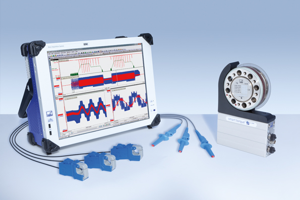

Key components in modern EV motor testing facilities today include analysis software able to synchronize readouts of mechanical and electrical test signals, a digital torque sensor (right), and current probes (left) and voltage probes (center) for measuring inverter outputs.

Test setups designed specifically for EV motors help show how motors are likely to perform in real conditions. They now provide full access to raw data, and handle synchronous measurement data acquisition for mechanical and electrical signals. For example, a setup developed by HBM includes a T12 digital torque transducer that records torque and speed as measurement variables. It also includes a high-speed data-acquisition system that synchronously records electrical signals from the inverter and motor as well as torque transducer data. Finally, measurement-data software gives access to raw data and lets developers analyze it later as well.
Measurement-data software can process data rapidly so measured values appear on-screen in just a few seconds. This contrasts with measurement systems that only use power meters. Power meters have a relatively long processing time, sampling data at a rate of one to 20 values/sec. It takes time to put this kind of data up on a screen.
