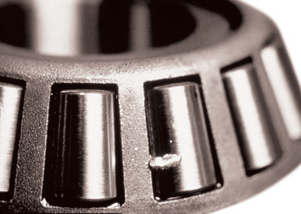

Large particles wedged in the soft cage material created a groove.

Sand, fine metal from grinding or machining, and fine metal or carbides from gears can wear or lap rolling elements and races. Abrasive wear also affects other machine elements and accelerates seal wear, degrading performance. Some reasons why fine particles accumulate include improper cleaning of housings and parts, and ineffective filtration or improper filter maintenance.
Hard particles rolling through bearings can pit and bruise the rolling elements and races. Bruising raises metal around the dents, which act as surface-stress risers to cause premature spalling and shorten bearing life. Metal chips or large pieces of dirt remaining after machining due to improper cleaning can initiate early fatigue damage. The internal debris can come from worn gears, splines, seals, clutches, brakes, and joints, as well as improperly cleaned housings and damaged or spalled components.
Hard particles such as chips and metal fragments can also get wedged in the softer cage material and create grooves in rolling elements. So called “grooving” leads to improper rolling-contact geometry and shorter service lives for bearings.
