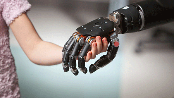

Prosthetic Actuation
In Phase II of the Revolutionizing Prosthetics 2009 program, researchers at Johns Hopkins designed a neuroprosthetics arm that was used in the clinical trial. Researchers at APL found that a person requires 50 Wh for daily upper limb activity. A removable, chargeable lithium-polymer battery , which maintains high energy density, powers the prosthetic arm. The arm uses lightweight carbon fiber and titanium to reduce weight, and the gear train takes advantage of a friction planetary reduction stage to decrease noise and provide the required strength. The torque output can reach as high as 60 N-m in the upper arm.
The upper Phase II limb uses electromechanical actuation with drives at nearly every joint. Electromechanical actuation was chosen because parts are compact, safely insulated, modular, and readily available on the market, adhering to the 24 months allowed for Phase II design. Modular parts were manufactured by HDT Robotics, with components manufactured by Micro Waterjet. To eliminate messy wiring and improve compactness of the arm, electronic and mechanical interfaces coexist at the joints. For instance, local small motor controllers (SMCs), drives, and motors are all built into the joints at the hand and wrist.
The prosthetic hand posed challenges in actuation design for APL researchers because it requires high torque to grasp objects, but has limited room for components.  DARPA required that all actuators in the hand have a common drivetrain to increase reliability and decrease weight and bulk. The developmental team chose an intrinsic, locally acting actuation system, rather than put components in the forearm, to make the prosthetic available for trans-radial amputees (limb missing below the middle of the forearm).
The joints that connect the fingers to the palm (MCP joints) each have two drives, one for flexion/extension (finger curling) and another for abduction/adduction (finger spreading). Three-stage planetary drives were used for finger spreading and cycloidal drives for finger curling. Miniature brushless linear DC (BLDC) motors power the drives. Planetary and cycloidal transmissions were chosen because of their small packaging and high gear ratio for torque actuation. All finger joints have one drive for each degree of motion (DOM) in the joint and an embedded SMC for position and velocity control.
The thumb has four DOMs and uses three-stage planetary drives for actuation. That’s because they’re smaller than the cycloidal drives, yet have a similar gear ratio for high torque.
For precise motor control of the hand, SMCs are imbedded at each joint. They all communicate directly with the main circuit board’s limb controller through an RS-485 communications bus. Conversely, large motor controllers (LMCs) are used to control more than one joint, including the four upper arm joints and the three wrist joints. The LMCs are responsible for BLDC commutation, sensor signaling, and communication with the main circuit’s limb controller. LMCs also monitor local joint sensors for temperature, torque, position, current, and rotor position for motor commutation.
While sensors on the hand and arm were used for control by the LMCs and SMCs, force sensors also were implemented to create the illusion of touch. When a sensor on the prosthetic came in contact with an object, a small vibrator at the pectoral nerves activated, creating the illusion of touch. The team is still developing cosmesis methods to make the arm look more natural. So far, function seems to be down pat.
