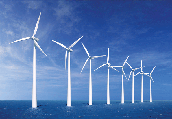

Wind turbines last longer than ever thanks to continuous engineering improvements.
