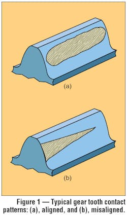

Gear tooth contact patterns. (Complete this step before disassembling gearbox components for inspection). The way in which mating gear teeth contact indicates how well they are aligned, Figure 1. If practical, record tooth contact patterns under either loaded or unloaded conditions. For no-load tests, paint the teeth of one gear with marking compound. Then, roll the teeth through mesh so the compound transfers the contact pattern to the unpainted gear. Lift the pattern from the gear with scotch tape and mount it on paper to form a permanent record.
For loaded tests, paint several teeth on one or both gears with machinist’s layout lacquer. Run the gears under load for a sufficient time to wear off the lacquer and establish the contact patterns. Photograph the patterns to obtain a permanent record.

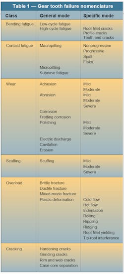

Determine type of failure
Now it’s time to examine all of the information and determine how the gear (or gears) failed.
Several failure modes may be present and you need to identify which is the primary mode, and which are secondary modes that may have contributed to failure. Table 1 lists six general classes of gear failure modes, of which the first four are the most common. An understanding of these four common modes will enable you to identify the cause of failure.

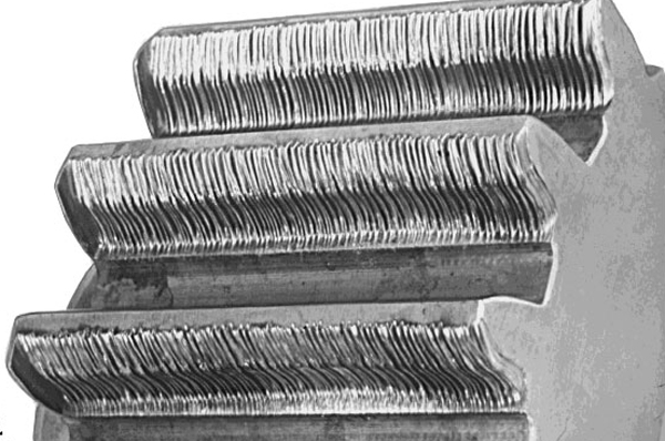

4. Scuffing. Severe adhesion or scuffing transfers metal from the surface of one tooth to that of another, Figure 8. Typically, it occurs in the addendum or dedendum in bands along the direction of sliding, though load concentrations can cause localized scuffing. Surfaces have a rough or matte texture that, under magnification, appear to be torn and plastically deformed.
Scuffing ranges from mild to severe. Mild scuffing occurs on small areas of a tooth and is confined to surface peaks. Generally, it is nonprogressive.
Moderate scuffing occurs in patches that cover significant portions of the teeth. If operating conditions do not change, it can be progressive.
Severe scuffing occurs on significant portions of a gear tooth (for example, the entire addendum or dedendum). In some cases, surface material is plastically deformed and displaced over the tooth tip or into the tooth root. Unless corrected, it is usually progressive.
