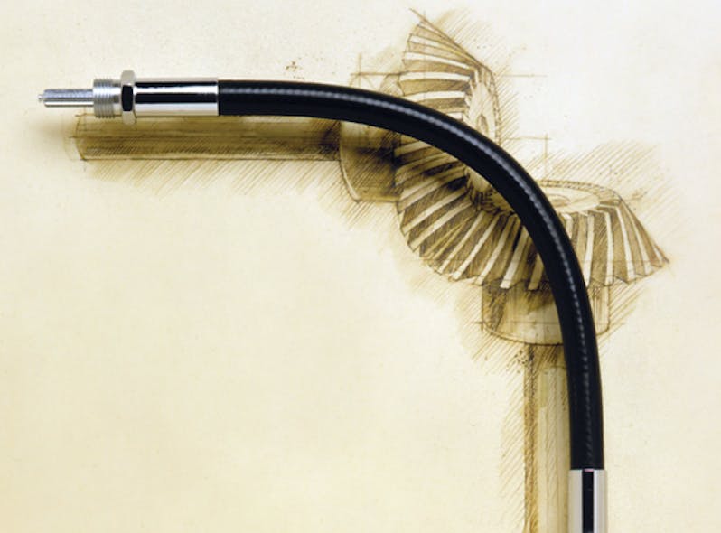

One-piece flexible shafts permit greater design freedom because they eliminate the complex coordination of multiple components. System designers can incorporate flexible shafts at any project-development stage and install the shafts in minutes without special tools or skills. A flexible shaft can run almost indefinitely in a straight configuration.
Flexible shafts are mechanical power-transmission devices used to transmit rotary motion through bends and curves. They can be routed over, under, and around obstacles which would be otherwise impossible for a solid shaft — and costly for universal joints.
Flexible rotary shafts eliminate tight installation tolerances and difficult assembly procedures required with solid shafts.
Flexible shafts are made of layers of high-tensile wire wound over each other at opposing pitch angles. When torque is applied to the flexible shaft, the wire layers expand or contract depending on the direction of the rotation. If the torque causes the outer layer to contract, the layer underneath will expand. This creates a dynamic interference between the layers of the shaft resulting in high torsional stiffness — approximately 100 times greater than the sum of the individual layers acting alone.

System designers opt for flexible shafts when rigid shafts just won’t work. But flexible shafts also eliminate alignment problems because they do not require tight tolerances. This gives designers more options when positioning motor and drive components, and they permit a full 180° offset while maintaining efficiency. Engineers can use flexible couplings or universal joints, but they allow only 5 to 30° offset and reduce efficiency by 40 to 50%. Flexible shafts in general are 85 to 95% efficient, which is typically better than gears, universal joints, and belts and pulleys, which lose efficiency because of higher frictional losses. And they have a 3 to 1 weight advantage over these other design options.
They also install in minutes without special tools or skills. Installation of solid shafts, gears, pulleys, and universal joints require precise alignment and skilled mechanics. The bearings and housings for solid shafts and gears require precise machining operations. Flexible shafts eliminate the need for tight tolerances and high costs.
Another perk is that system designers can incorporate flexible shafts at any project-development stage. Conventional rotary-motion devices must be engineered early on because of their rigidness, defined configurations, and large mass. One-piece flexible shafts permit greater design freedom because they eliminate the complex coordination of multiple components.

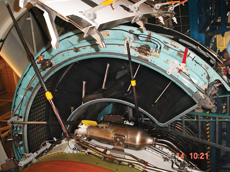

Because of these variances in size paired with high yield strength, flexible shafts are used extensively in the aerospace, medical, automotive, and other industrial markets. For example, engine-thrust reversers use flexible shafts to transmit power to actuators which drive thrust-deflection doors, or vanes, on most commercial aircraft jet engines. The deflectors reverse the direction of thrust from the engines, slowing the aircraft on landing.
Flexible rotary shafts transfer power from thrust-reverser actuation systems on jet engines.
