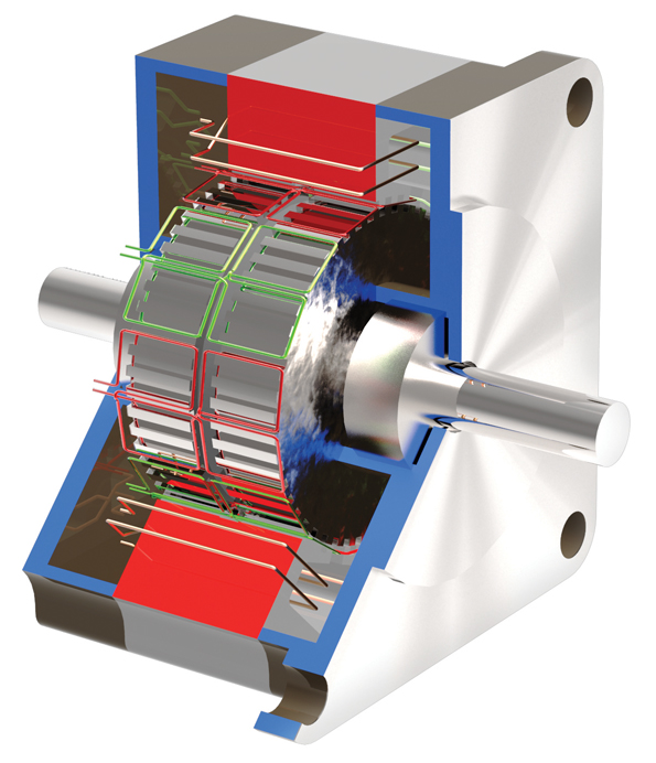

This 23-frame high-pole-count ac motor-resolver combination, called a Mosolver, incorporates components that function as an emulated resolver with a resolution to 32,000 counts/rev. The Mosolver is also adaptable to other frame sizes and motor types.

This hybrid servomotor has a rotor featuring one axially polarized magnet (black) sandwiched between upper (green) and lower (blue) rotor caps made of magnetic soft-steel laminates. Assume the upper cap is north and the lower cap is south. In the three-image series (bottom), a stator tooth (grey) couples to the rotor magnet in an ever-changing way. First the stator tooth aligns with the top (N) rotor tooth. Then as it rotates, it “sees” less and less of the upper tooth (N), and more of the lower tooth (S), finally seeing primarily the lower tooth (S). As the tooth continues to rotate, coupling gradually wanes from the bottom tooth (S) and back to the next top tooth (N). As the rotor rotates one full revolution, this pattern repeats for each rotor-tooth pair (50 times total). Thus, one magnet combined with two toothed rotor pole pieces acts as a 100-pole rotor when viewed from any particular stator tooth.
Now assume the rotor is positioned so its lower teeth align best with the teeth on the stator’s 1 and 5 structures and its upper teeth align with the teeth on the stator’s 3 and 7. Here, the motor is stable if the drive energizes phase A to produce north poles at 1 and 5 and south poles at 3 and 7. In contrast, if B is energized to produce north (N) poles at 2 and 6 and south (S) poles at 4 and 8, the (S) lower rotor teeth near 2 attract the (N) stator teeth and produce a clockwise torque. Repulsion of the (N) upper rotor teeth by the (N) stator teeth also produces a clockwise torque. In fact, a similar interaction takes place at 4, 6, and 8 to produce clockwise torque.
If the rotor can rotate but the stator windings aren’t commutated, the rotor turns one half-tooth clockwise and comes to rest. If the stator windings are varied to move stator attraction clockwise with respect to the rotor, the motor continues to spin. Reversing the offset reverses the torque.
To understand the position sensing, consider how each pole structure in this example has six top teeth adjacent to the upper rotor cap and six bottom teeth adjacent to the lower rotor pole cap. The 12 teeth on each pole piece can be grouped into quadrants.
Both sensor and stator coils have multiple turns but are depicted here with single turns for clarity. This is just one example of a Mosolver sense-coil installation, and engineers can integrate Mosolver feedback into other motors as well.
