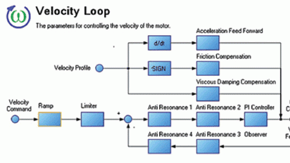

Not surprisingly, a key function of the servo drive is the execution of servo algorithms. Many position/velocity loop architectures are used in modern servo systems, such as integrating position loops vs. integrating velocity loops. In both cases, high servo gains generally contribute to faster response to both commands and disturbances. However, the placement of the integrator can favor different applications. For example, integrating position loops are often used when following error (the position error during a move command) should be minimized. On the other hand, integrating velocity loops are often used when the fastest response is needed.
Another family of functions that can help improve servo systems is feed-forward. Feed-forward gains are added paths that speed response to command signals. Servo loops function by minimizing error: More position error generates a larger velocity command, which closes the error more rapidly. But loops take time to respond. In contrast, feed-forward is nearly instant and so allows the servo machine to respond much faster.
Consider the effects of gravity on an overhung load such as an unbalanced vertical axis with a brake. If servo loops are enabled without feed-forward and the brake is released, initially the current command is zero, so the load falls a little. As the servo has time to react, current increases and the axis is eventually restored to the position where it was when the drive was enabled. However, the observer sees a momentary drop. With offset feed-forward, the user can tell the drive how much current is required, and the servo loops can be preset to that value before the brake releases. That way, when the brake releases, the load barely moves.
Current offset is just one type of feed-forward; other types include acceleration, velocity, viscous damping, and Coulomb friction feed-forward. All of these functions share a key characteristic: The drive calculates the ideal response and adds auxiliary signals to the loop paths so that the output responds much more quickly to expected disturbances than a servo loop without feed-forward. Of course, feed-forward gains are no substitute for high servo gains: All demanding applications require high gains to achieve rapid response. However, feed-forward improves even the best-tuned servo loops, working with the loops to provide the most rapid response possible.

The initial solutions to compliance are mechanical in nature, with two main alternatives available. The first is to reduce compliance by using stiffer transmission components, such as servo-quality gearboxes, lead screws, and couplings to minimize compliance issues. The second is to match the inertia of motor and load: That way, when the load disconnects from the motor, the total inertia changes only by a factor of 2:1. (Note: If the load is 10x the motor, the total inertia goes down by a factor of 11:1 at high frequency.) Although these solutions are adequate, they have limitations. A transmission can only be so stiff before costs start getting out of hand, and increasing the motor size reduces acceleration and increases cost.
At this point, designers can turn to advanced anti-resonant servo algorithms to further improve performance. Anti-resonant algorithms are velocity-loop filters configured to vary servo loop response across the frequency band. Recall the stapler example where the servo loop experiences a total inertia that varies with frequency — large at low frequencies and small at high frequencies. The filters change the frequency response of the loop to compensate for that variation. Many alternatives exist for filter construction and placement in the loop. The simplest structure is to have a low-pass filter or two in the feedback path. Such filters are easy to use, but limited in the amount of improvement they can provide. More advanced filters include notch filters (those that attenuate a narrow band of frequency) and higher order filters, which attenuate more rapidly with increasing frequency. The most flexible filter is the bilinear-quadratic (bi-quad) filter, a design that can be configured as a low pass, notch, or any number of other filter types.
