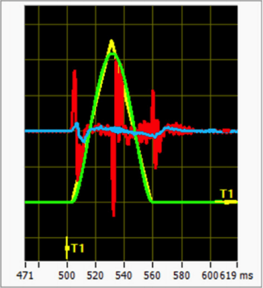

Shown here is the Regular Profile vs. MotionBoost. Yellow is the regular profile. Green is the MotionBoost profile. Red is the regular profile’s position error. Blue is the MotionBoost position error.

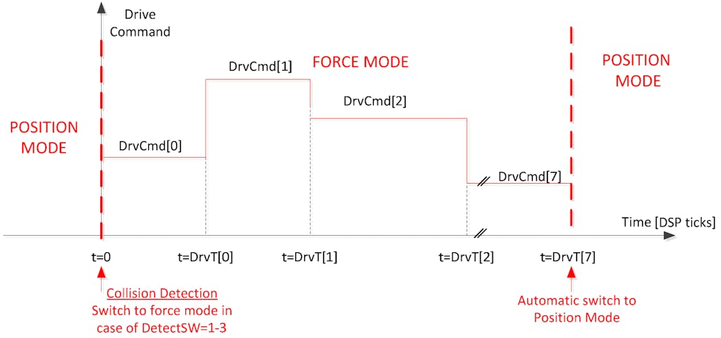

Algorithms also speed the wire-bonding process. Soft Touch force control quickly detects contact based on position error, drive command, or analog input (from a force transducer). Its nonlinear spring compensation, gravity compensation, and a damping mechanism limit impact force and suppress vibrations. After a collision is detected, force is applied based on a pre-defined timing diagram … after which the system switches back to position mode:
Transitions from position to force mode and back happen within 50 μsec.
ServoBoost (a servo algorithm) maximizes bandwidth and zeros settling time for sub-micron resolution; MotionBoost (a new motion-profile algorithm) minimizes settling time and maximizes dynamic performance. Motion profiles at the real-time servo update rate of 20 kHz smooth motion with durations even as low as 100 to 500 μsec. MotionBoost profile generation beats out second and third-order motion profiles by reducing drive current during aggressive moves — which in turn boosts throughput.
