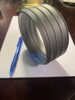

EU: The Downhole Emerging Tech project is a good example of DfAM getting a viable product up and running quickly. [Background: The U.S. Department of Energy (DOE) put out a call for engineers and scientists to address challenges associated with operating sensitive equipment in harsh geothermal environments. Houston-based startup Downhole Emerging Technologies (DET) responded to the challenge and turned to ProtoLabs for design assistance in developing a packer or plug system.] In this case the customer uploaded an early concept that would not print cleanly. But after some quick advisement they were able to modify the design to require nearly no support structure and have as little labor as possible.
The internal structure of the part made it non-conducive to being made more conventionally. For Protolabs, our automated tool on the website provided some initial, instant feedback and, in the case of this part, it came from discussions with our applications engineers on how to design the part to be self-supporting. We provide a lot of easily accessible content on how to design for DMLS (direct metal laser sintering), the process used in making DET’s component.
