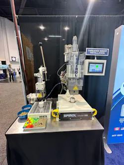

Manual Insert Method
At the manual machine (Model HM Heat Insert Driver), an operator loads the insert into the plastic assembly. They pull the handle, which transfers heat from the heated tip to the insert and into the plastic, softening the plastic around the insert.
The machine is equipped with an internal air spring, so the operator cannot cold-press the insert into the plastic. It installs inserts ranging from M2-M6 metric threads and #2-1/4 unified threads. According to the Spirol’s product notes, as much as 75% of an insert’s performance is directly related to the quality of installation. It underscores why all factors influencing installation must be meticulously managed.
READ MORE: Joining Plastics: Smarter Welding, Better Designs, Stronger Assemblies
At the demo bench, when the arbor press lever is pulled all the way down, it makes contact with the insert and dwells for a couple of seconds, until the plastic is sufficiently melted so that the insert installs at the right temperature.
“I’m pulling this down,” explains Jones. “I’ve made contact, it’s dwelling and now the insert is installing into the plastic assembly. I know it’s fully installed because there’s a mechanical stop here with a micrometer adjustment to ensure installation at the exact depth and location.”
Automatic Insert Method
Performing the same task at the automatic heat machine (Model HA Automatic Heat Insert Driver), Jones pointed out that inserts are contained in a vibratory bowl feeder. Inserts are simply loaded into the feeder, so the operator doesn’t have to touch the inserts.
The inserts then travel through a feed tube and are preheated to the correct temperature. “It’s going to transfer heat from the heated tip to the insert, soften the plastic around the insert, and the machine is equipped with an internal air spring, which means that as hard as [the operator] pulls down on the lever, the insert will not install into plastic until it’s sufficiently softens the plastic around the insert,” Jones explained, adding that the insert is fully installed into the plastic, automatically dialing in time, temperature and pressure.
READ MORE: An Application Engineer’s Insights on Fastening and Joining Components
“When I actuate the machine using the dual opto-touch sensors—which keep me safe and ensure I don’t burn myself—you’ll see that installation appears almost instantaneous, because the inserts are already at temperature.
The machine handles threaded inserts from M2 to M8 metric and up to #2 to 3/8 unified threads. “This machine is currently installing one insert at a time, but it can be configured to install two, three or four inserts simultaneously,” said Jones.
Two Methods, One Outcome
The distinction between the two methods is essentially how heat is controlled and when it enters the process. With the manual insertion, heat is applied at the point of contact and held for a controlled dwell. The automated system moves the thermal step earlier by preheating the insert.
But the goal remains the same: Hit the interface temperature so the insert seats securely and becomes a strong, load-bearing part of the plastic assembly.
