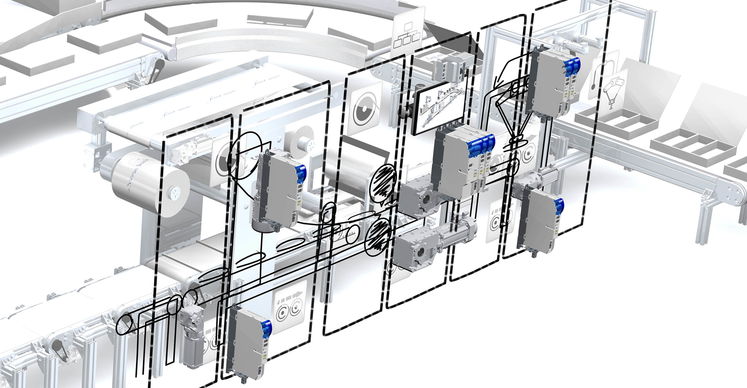

Selecting the Topology
Complex designs with several functions, more than one axis of motion and multi-dimensional movement, and faster output and throughput make system topology just as complicated. Choosing between centralized, controller-based automation or decentralized, drive-based automation depends on the machine being designed. What the machine does, both its overall and local functions, affects whether you opt for centralized or decentralized topology. Cabinet space, machine size, ambient conditions, and even installation time also affect this decision.
Centralized automation. The best way to get coordinated motion control for complex machines is with controller-based automation. Motion-control commands are usually forwarded to specific servo-inverters via a standardized real-time bus such as EtherCAT, and inverters drive all the motors.
With controller-based automation, several motion axes can be coordinated to perform a complex task. It is ideal topology if motion is at the heart of the machine and all parts must be synchronized. For example, if it’s critical for each motion axis to be in a specific place to get to properly position a robot arm, you’ll likely choose controller-based automation.
Decentralized automation. With more compact machines and machine modules, decentralized motion control reduced or eliminates the load on machine controls. Instead, smaller inverter drives assume decentralized control responsibilities, an I/O system evaluates control signals, and a communication bus such as EtherCAT forms an end-to-end network.
Decentralized automation is ideal when one portion of the machine can take responsibility for completing a task and doesn’t have to constantly report back to central control. Instead, each portion of the machine performs quickly and independently, only reporting back once its task is complete. Because each device handles its own load in such an arrangement, the overall machine can take advantage of more distributed processing power.
Centralized and decentralized control. Although centralized automation provides coordination and decentralized provides more efficient distributed processing power, a combination of both is sometimes the best choice. The final decision depends on overarching requirements including goals related to:
