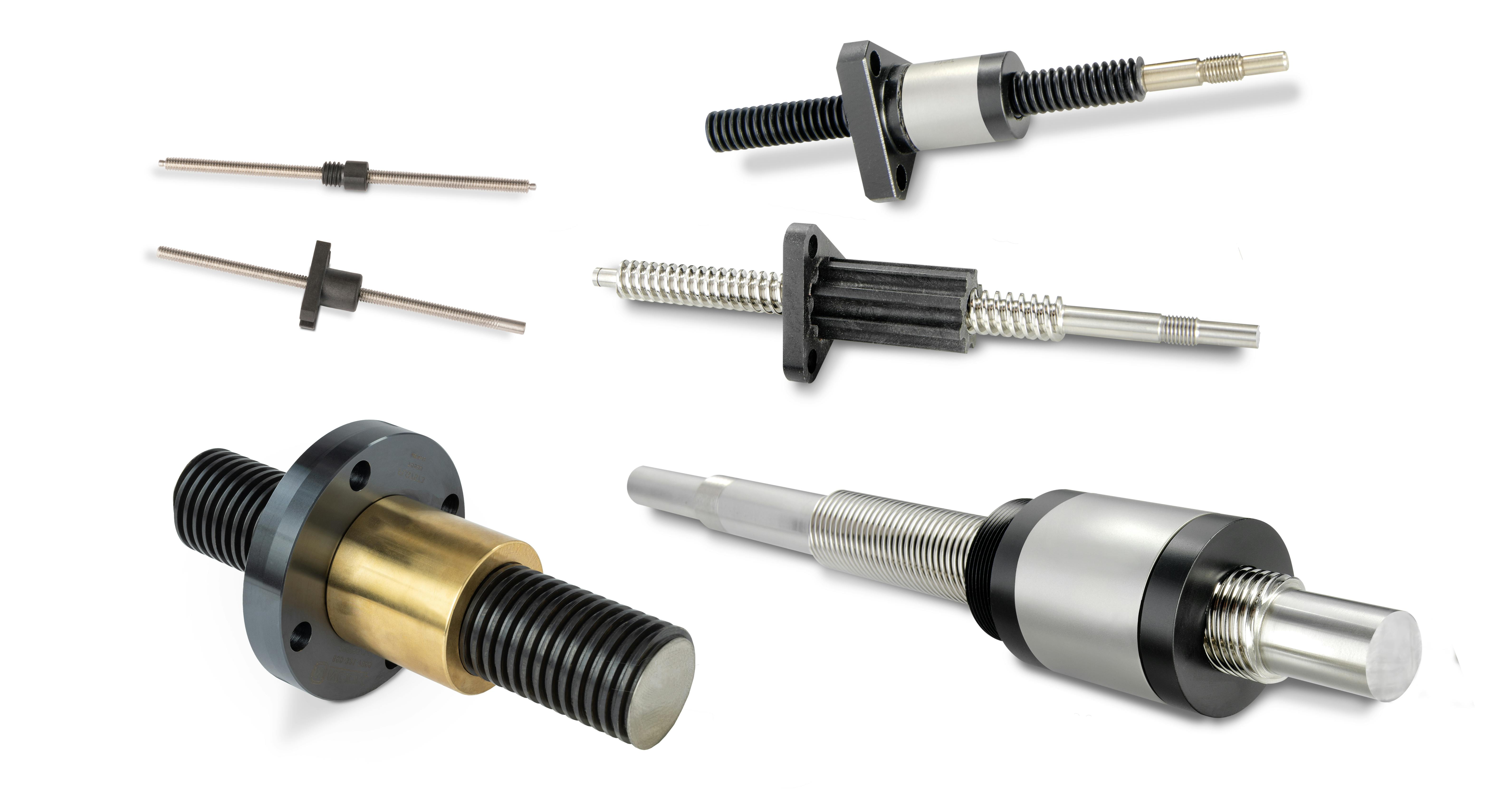

Lead screws are often called the workhorses of motion control. They consist of a threaded shaft and a nut that carries the load along the shaft or guides the shaft in moving the load, and they derive energy from an attached servo or stepper motor.
OEM designers have thousands of off-the-shelf lead screws and related components from which to choose, but every motion profile is different and achieving the perfect fit for any single application is often challenging. While experienced motion engineers and automated selection tools can get you close to an ideal solution, optimization will almost always require a degree of customization. Understanding the wide range of available options will help you determine the potential role and need for customization in your applications.
What can you Customize?
Customization must always begin with an appreciation of the end-user’s needs, which will eventually translate to specific design requirements and, ultimately, the motion solution. Lead screw shafts integrated with servo or stepper motors offer what may be the widest range of customization options. Following are the most common candidates for customization:
  • Screw shafts, such as changing pitch or leads, length, stroke and end journaling.
  • Nuts, such as carriage shape and size, flanges and press fitting.
  • Materials, such as changing stainless steel bearings or aluminum or plastic housings; nuts or bushings made in a special metal, plastic, composite or ceramic materials.
  • Surface treatments, such as paint quality or color and thickness of anodized aluminum parts.
  • Mounting, such as orientation brackets, along with various couplings or angles.
  • Connections, such as tooling.
  • Keyways, such as flats to secure the screw to a motor or driven component; bore sizes.
  • Integrations, such as hybrid systems combining screw, nut, gearing, rail support and stepper motor.
  • New designs, such as adapting existing products for new functionality or designing a new product or system from scratch.
  • Services, such as lubrication, stocking, transportation, training, repair and maintenance.
