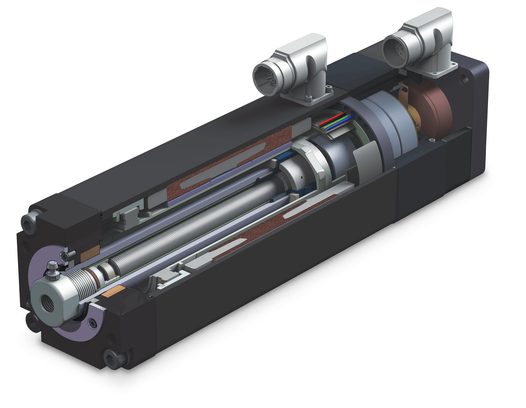

Today’s automation industry increasingly relies on high-performance electric actuators, especially integrated actuators, because of their dynamic responsiveness and precision capabilities. When assessing actuator performance for designs, engineers often rely on continuous force/speed curves derived from motor performance. But these curves don’t completely represent the intricacies of the integrated linear actuator’s performance. Integrated actuators have a number of unique attributes that contribute to the overall performance of the entire linear motion system.
Because they don’t depict the overall actuator performance, overreliance on continuous force/speed curves can lead engineers to undersize actuators for their designs, resulting in system performance issues and costly delays. Although continuous force/speed curves enable high-level estimations, they don’t account for all losses inherent to a complete integrated actuator system.
To specify an integrated actuator and ensure its performance meets expectations, engineers should consider all mechanical and thermal limitations of the actuator system. Not only does this complete approach save time and money by avoiding underperforming systems, it also maximizes actuator usability. The first step is to evaluate integrated actuator performance within the context of full system operation by looking beyond continuous force/speed curves.
