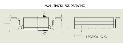

Wall Thickness
Parts should maintain a uniform wall thickness throughout their entirety, but this should be easy because parts are formed from a single sheet of metal.
