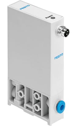

Yusuke Ishii, director of Tmsuk, noted in a press note that Festo’s VEAA and VEAB proportional pressure regulators are used in the application to control most of the robot’s 24 pneumatic cylinders moving the robot’s arms, legs and fingers, as well as the mouth, eyelids and irises. “The proportional pressure regulators VEAA/VEAB are 3/3-way valves, each of which combines a pressure sensor and electronic controls,” said Ishii.
“Proportional valves with piezo technology require virtually no energy to maintain an active state thanks to their capacitive capability,” said Ishii. Each valve operates like a capacitor: it needs energy only to charge the piezo ceramics; no further energy is needed to maintain that state.
The Pedia Roid’s smooth, lifelike movements are produced using Festo proportional pressure regulators VEAA and VEAB. Festo
The piezo valve operates like a capacitor. Current is needed at the start to charge the piezoceramics, explained Festo, and since no further energy is needed to maintain its state, the valves don’t heat up. Piezo valves consume up to 95% less energy than solenoid valves, which require an electric current.
