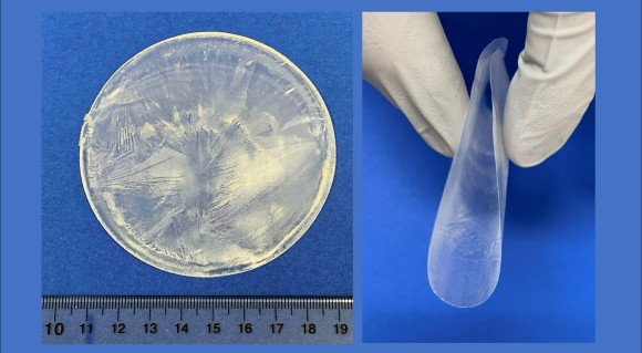

A novel example focuses on implantable piezoelectric therapeutic devices. Bioengineers at the University of Wisconsin’s Department of Materials Science and Engineering are taking advantage of the piezoelectric properties of non-rigid, nontoxic biological materials such as silk, collagen and amino acids.
Led by Xudong Wang, Ph.D., professor of Materials Science and Engineering, the research team devised a self-assembly method of small patch-like constructs. The wafer-thin, flexible devices use the amino acid lysine as the piezoelectric generator.
The researchers explained that the self-assembly process incorporates a biocompatible polymer shell that surrounds the lysine as the polymer/lysine solution evaporates. A chemical interaction occurs between the inner layer of lysine and the polymer coating. This interaction, noted the researchers, is critical for orienting the lysine into the crystal structure necessary for it to produce electric current when flexed.
