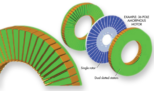

One commercially available amorphous-iron motor uses a two-stator PM brushless configuration. Each stator has 54 slots. The rotor has 36 poles. The amorphous iron is green in this diagram. The motor is designed to operate at 1,000 rpm.

But the amorphous motors that power such applications will probably have topologies unlike those of conventional brushless motors due to the realities of working with amorphous-iron foils that are only 25-microns thick. The magnetic teeth, for example, will likely be smaller than those of conventional silicon-iron motors. The practice of using small amorphous teeth lends itself to the construction of motors with a high pole count. One commercial design uses two stators each containing 54 amorphous-iron poles. The full-speed frequency of this device is 1 kHz.
