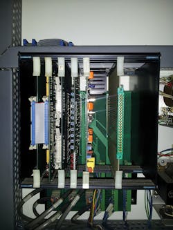

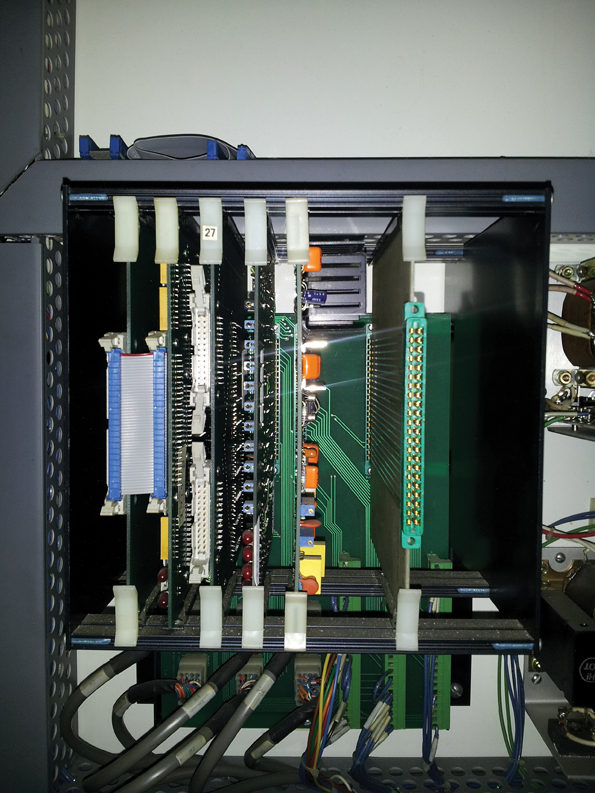

The original controllers on the Micromatic Textron honing machines used a number of circuits boards.

In one class of honing machines manufactured by Micromatic Textron, Berne, Ind., the cutting head rides on rails and is driven by a hydraulic cylinder. To generate crosshatch grooves, the cutting head traverses, then reverses at a precise point. That requires closed-loop hydraulic motion control.
The original honing machines relied on a custom-designed motion controller for the task. But after more than two decades of use, the machines were showing their age. And service information on the original, proprietary controllers was hard to obtain. Controllers that needed service had to be sent back to Micromatic for repairs. Ultimately, obsolescence made the original controllers too costly to maintain. To overcome this problem, Kenrie is extending the productive life of these old, but still-valuable, machines by retrofitting them with new control systems.
