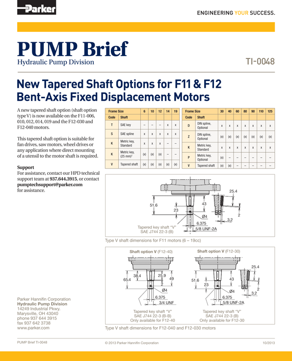

A new tapered shaft options for F11 & F12 bent-axis fixed-displacement motors is suited for fan drives, saw motors, wheel drives, or any applications where direct mounting of a utensil to the motor shaft is required.
