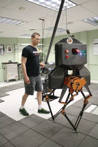

Jonathan Hurst and his robot, Atrias 2, go for a walk around his laboratory. The robot uses the tether for safety support and to guide it around in a circle. The tether does not supply power or controls signals.

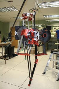

Atrias 1 is a monopod or one-legged robot and, fortunately, the mass-spring model works for one-legged locomotion. “Although we knew the ultimate robots would have two legs, we started with a monopod because it would be simpler and less expensive,” explains Hurst. “It lets us see what would and wouldn’t work, and then use those lessons on Atrias 2.

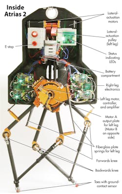

Atrias 2 is built as a testbed for exploring walking robotics that use a simple spring-mass model of a walking leg. It has been described by its developer, Jonathan Hurst, as a walking pinch point, a reference to the fact that it is not really safe for the general public and he and his team must be careful when operating it.
Both robots have legs made of carbon-fiber tubes with small, aluminum components making up the knee joints. The theoretical mass-spring-model on which the robots are based calls for massless limbs, an impossibility. “The legs weigh about 2.5 pounds and support the entire 132‑pound robot, so they represent about 3% of the robot’s mass,” notes Hurst. “They obviously couldn’t be massless, and their mass means that every time they hit the ground, there’s an inelastic collision that wastes energy. But we knew we couldn’t match the ideal components in the model. The mass is small enough, though, that we consider it negligible.”
Both Atrias 1 and 2 rely on fiberglass plate springs. The team ruled out air springs because they exhibit some hysteresis, and are nonlinear and not too efficient. And coil springs were not used because they don’t have enough energy density. Instead, both robots are outfitted with fiberglass springs that are relatively light for the energy they store. The goal is to store about 100 J. They also closely follow the traditional spring equation, F = kx, regardless of the direction they are flexed, and can be built with any spring rate. Hurst uses fiberglass from Gordon Composites, Montrose, Colo., a firm that sells similar materials to companies making archery bows. Fiberglass springs are also used to damp vibrations in heavy machinery and as springs in furniture.
Atrias 1 is a single-legged walking robot, the predecessor to Atrias 2. Like Mabel, it used a cable-based transmission and fiberglass springs.
Atrias 1 used cable drives to move its single leg. They were all pretensioned and each cable terminated on a pulley, so power never got transmitted through friction. “Cable drives are incredibly efficient and have zero backlash,” says Hurst. “That is important because we repeatedly apply positive and negative torques as the leg goes back and forth. Gearboxes, another option, all have some degree of backlash.”
Cable drives are also light compared to the torque they can transmit. Atrias 1’s drive had hundred of Newton-meters put through it, yet it didn’t weigh much, according to Hurst. The major downside is the size.
So for Atrias 2, which would have two legs and would have required two cable drives, the team switched to a harmonic drive. It is compact, but has other issues. “For example, it is inefficient and we waste energy trying to push torque and power through it,” says Hurst. “And we wanted a gear ratio of 23:1, but the smallest ratio we could use on a drive that fit our design was 50:1. This limited the design but it works.”
Atrias 2 carries four motors, two for each leg. For the leg motion, the team chose a pair of brushless, frameless dc motors. The team custom built housings and sensors for them. “These motors control leg length and swing and are the main locomotion motors,” says Hurst. “They had to be pancake motors with large diameters, minimal mass, and good torque density.”
The other two motors control abduction and adduction for lateral balance and ended up being standard motors from Kollmorgen, Radford, Va. “They aren’t as light as we’d like, but we mount them so that their mass has minimal effect, and it seemed a small price to pay in mass to avoid the expense of custom building two more motors.”
The robot uses 32‑bit Renishaw encoders on every degree of freedom to act as proprioreceptors. “They keep us informed of the position and speed of all leg components, the deflections of all the springs, speed of the motors, and orientation of the robot’s body,” says Hurst. “There are no sensors looking at the surrounding environment.”
Computing power comes courtesy of an I5, a small desktop computer running on an EtherCAT bus. Sensor and encoders are run from a microcontroller board that communicates over the EtherCAT net back to the computer. “The main PC runs a real time O/S that receives all sensor data, handles all the number crunching, and sends out commands, all at 1 kHz,” explains Hurst. “We wouldn’t be able to send that much data that quickly over a CANbus or any other alternative. We had to search far and wide to come up with this solution.”
Power for the 132‑lb robot comes from a 51.4‑V three-battery pack carrying lithium-polymer batteries usually used in model airplanes. The robot draws about 400 W when walking, so the pack let Atrias 2 walk for about 30 min.
