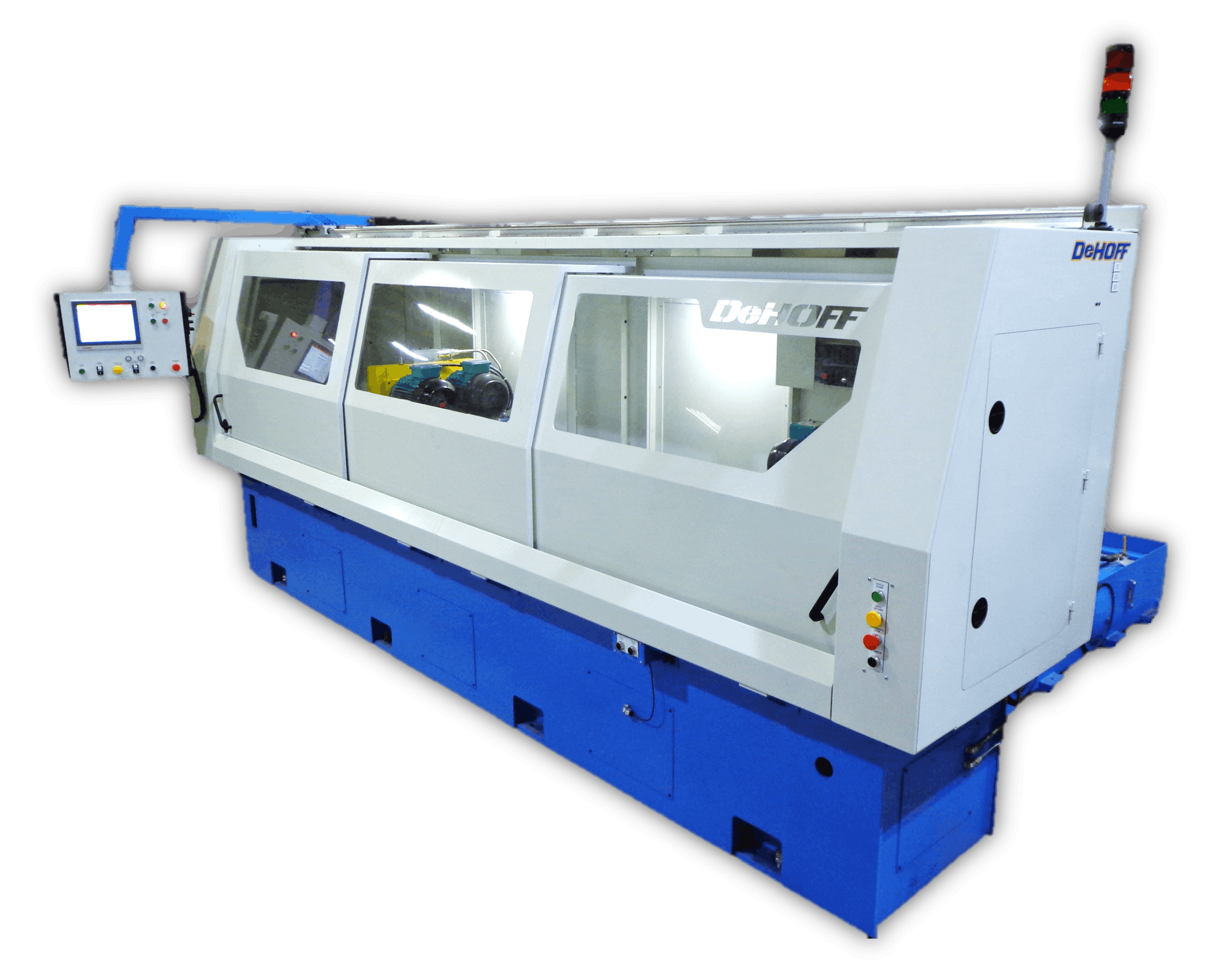

The DeHoff 20144 is a custom-designed for fusion reactors. It performs gundrilling, pull boring, roller burnishing and thread tapping on aluminum microwave guides.

Kays Engineering set up gundrilling machines from its three brands: DeHoff, Eldorado and TechniDrill. The DeHoff 20144 is a custom-designed gundrilling machine used to make components for the world’s largest nuclear fusion reactor, the ITER Tokamak. The Eldorado M75-30 gundrilling machine features a new design for its counter-rotation fixturing assembly, which improves the accuracy of the gundrilling process, and an upgrade on the gear motor assembly promises more power and durability.
The TechniDrill 2.00-30-48 gundrilling machine, which is used to manufacture airplane aileron actuation cylinders, features an actuation cylinder that starts as a solid bar. The gundrilling machine drills the large primary hole in a single pass, without the need for a pilot hole. Secondary processes are then utilized to finish the cylinder.
