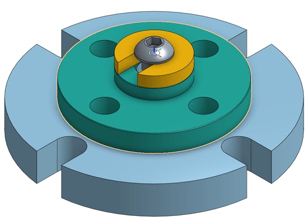

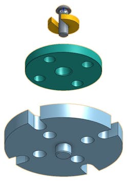

Drilling a bolt circle for a volume run of precision flanges is an application that demonstrates the potential of the MMC (M) bonus tolerance concept. In this example, let's assume the fixture is mounted to a rotary table on a manual knee-style milling machine (e.g., a Bridgeport) to perform the drilling operation.
The fixture’s purpose is to:
  • Orient and locate the flange based on the specified functional datum features of the part, typically the flange’s mating face (datum feature A), and its central hole (datum feature B in the example below). This ensures that the bolt circle is positioned relative to the flange’s functional features;
  • Securely clamp the flange to prevent movement during the drilling operation;
  • Provide clearance for the drill bit as it passes through the flange, providing space for chip evacuation and coolant passage.
Because the flange designer specified the hole position using position tolerance with an MMC modifier, the fixture does not need to precisely locate the individual holes in the pattern: It simply needs to accurately orient and locate the part to the specified datums on the flange. As the actual size of each hole deviates from their MMC size, their available positional tolerance increases. The fixture can have oversized holes (as shown below) to provide drill bit clearance and accommodate the additional position variance allowed through bonus tolerance.

Here is one possibility (amongst many possibilities) of a simple jig fixture design that would enable the machinist to drill the holes quickly and accurately. The base plate of this fixture has a locating feature that fits into the pilot hole for the rotating table. The base plate also has a locating boss for the flange through hole (datum feature B).
