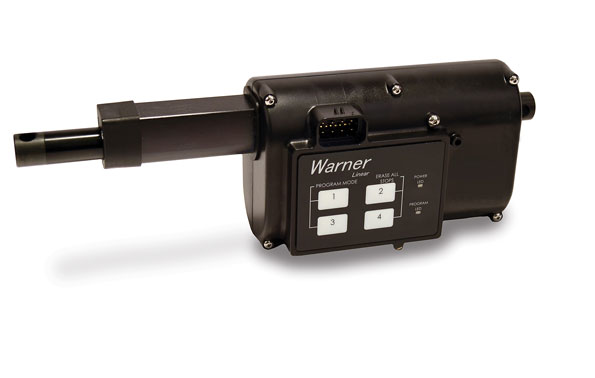

Programmable electric actuator
The S-Track line of linear actuators now offers a programmable model. Operators can set and reset end-of-travel positions as well as two intermediate stops. Feedback range automatically adjusts to new end position settings.
The actuator turns power off to the motor automatically when the internal end limits are reached. An integral MP150 Metri-Pack 8-pin molded connector allows several standard input and output features to monitor the operation of the actuator, including motor thermal and current overload protection. Feature include a <56‑dB noise level, 700‑lb maximum dynamic and static load rating, 0.25 ips (1‑in. no-load) speed rating, and a 16‑in. maximum stroke length with end-of-stroke limits.Warner Linear, 6593 Revlon Dr., Plant #1, Belvidere, IL 61008, (800) 825-6544, www.warnerlinear.com
