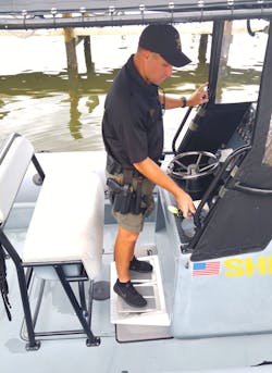

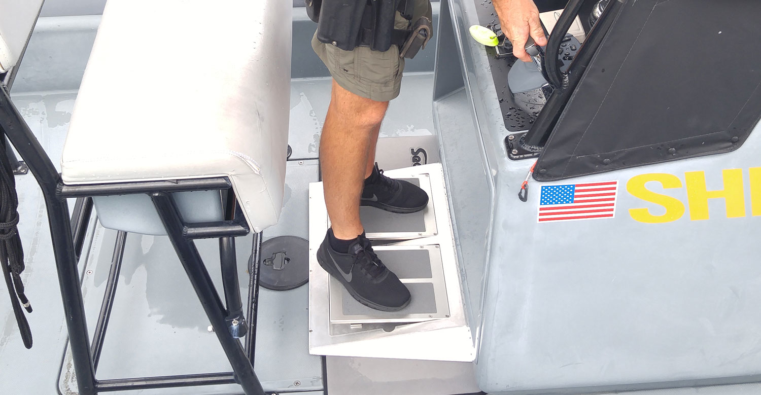

Nowack’s model includes a platform upon which the boat operators stand. Under the skid-proof panels are compressive devices that hinge and swivel to reduce the impact on the legs. The compressive units hinge on plastic bearings. “The bearings are taking the brunt of the impact,’’ he explained.
The bearings in Sea Knees are manufactured by igus, inc., a motion plastics manufacturer based in Germany that runs its North American operations out of Providence, R.I. Each Sea Knees unit includes eight igus bushings to help mitigate the shock from the ocean surf.
