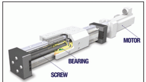

Unlike rod-style actuators, electric rodless actuators have the ability to both support and carry loads — which eliminates the need for other load-bearing and guiding elements. However, their multitasking nature means that sizing electric rodless actuators involves more than merely calculating force and stroke. Following are several tips for optimizing performance, reliability, and efficiency.

In contrast to rod-style actuators, a rodless actuator's stroke lies completely within the length of its body, resulting in a smaller working footprint. In addition, electric rodless actuators can be either screw or belt-driven, with each style benefitting certain applications.
