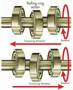

How they work
The bearings sit on a smooth, unthreaded shaft. Bearing angle determines travel direction and the linear pitch of the drive.
In either fixed or variable-pitch rolling-ring linear drives, the drive unit sits on a smooth, unthreaded shaft. High-quality drives use only induction-hardened, ground, and finished steel shafts with minimum surface hardness of 50 Rc, diametral tolerance of h6, concentricity tolerance (ISO 1101) <0.1 mm/m, and surface roughness Ra <0.35 μm.
Three or four rolling-ring bearings are housed inside the drive unit. Each bearing is specially machined to form a “ridge” — a specially shaped running surface — around the inner race. The shaft contacts each bearing on a single point of this ridge. When the shaft rotates, the bearings essentially roll along the length of the shaft and, thus, move the payload attached to the drive-unit housing.
The bearing angle determines the drive’s travel direction and linear pitch. In the variable-pitch version, the angle of the bearings relative to the shaft can be adjusted with a pitch-control lever. Turning the lever pivots the bearings on the shaft, which increases or decreases the linear pitch. This is accomplished without changing shaft-rotation speed. Thus a variable-speed linear drive does not need clutches, cams, or gears.
