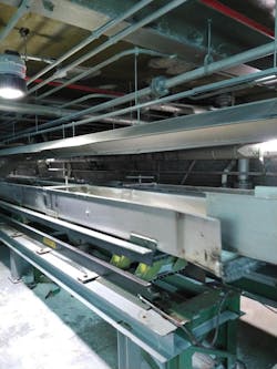

Example Application: Vibrating conveyor
A customer’s vibrating conveyor features a drive moving an unbalanced shaft that induces an eccentric motion on the trough. The trough in turn is supported by a system of springs that alternately store and release energy, which powers the up-and-over motion of the solids being conveyed. “The conveyor in this case was using an extraordinary number of springs and bushings causing increasing amounts of downtime,” explains David Webb, an associate mechanical engineer at Eastman. In addition, it seemed likely that replacement springs had different coefficients than the original springs, causing an overstroke on the machine and excessive wear. “The solution,” reports Webb, “was to rebuild the whole spring system to ensure all the springs were rebounding at the same rate.”
